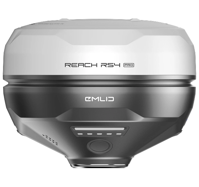

Reach RS4 Pro GNSS receiver. Discover surveying with dual cameras
With two Full HD cameras, the RS4 Pro takes surveying and stakeout further than traditional RTK can.

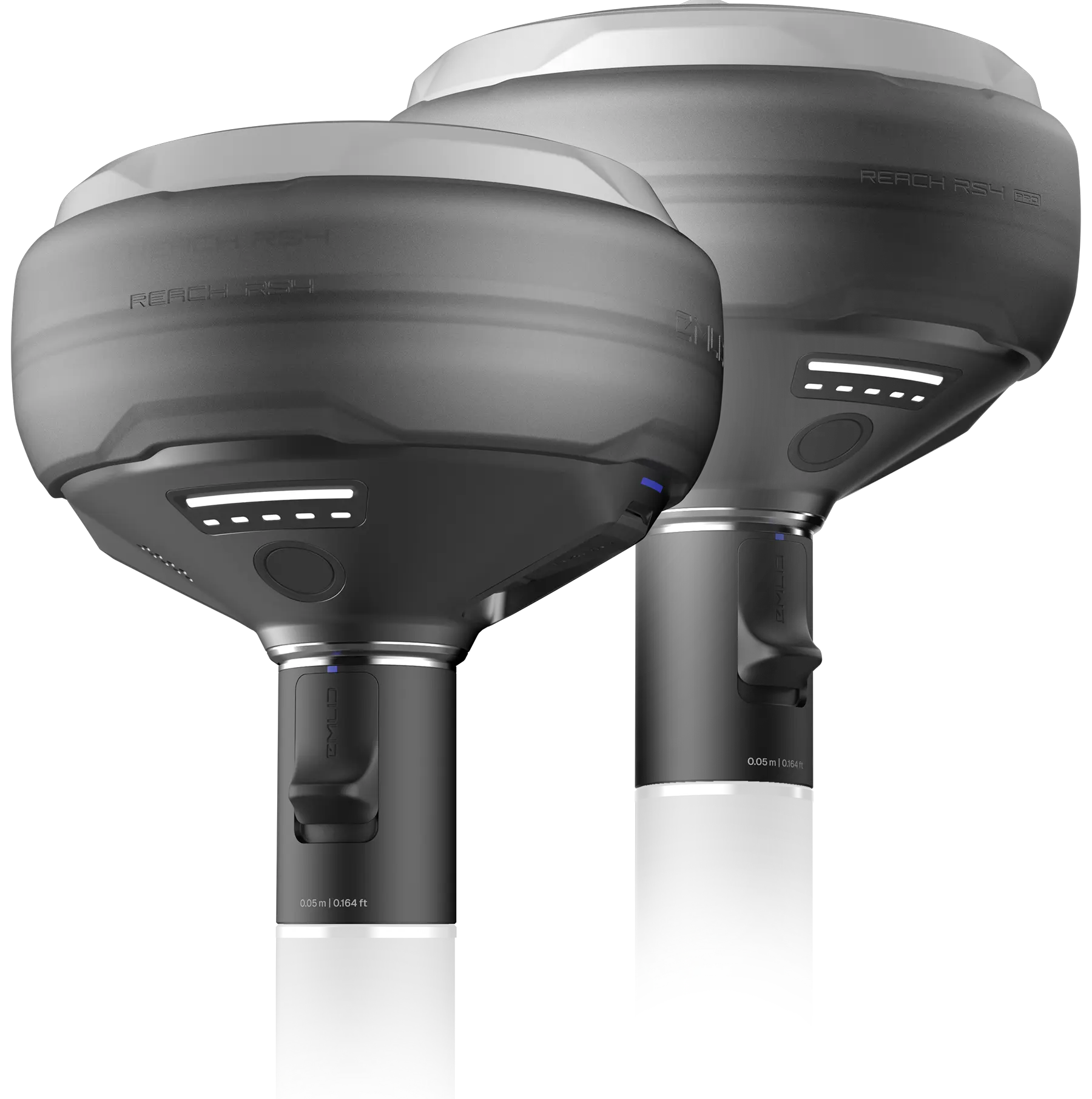

Next-gen tilt compensation
The advanced tilt compensation stays accurate even at steep angles. For example, at a 30° tilt, the Reach RS4 Pro still delivers 18 mm precision.1 Initialization takes just a few quick movements and remains stable throughout the job—no manual recalibration needed.
Factory-calibrated
Interference-proof
Rapid initialization
Unlimited tilt angles

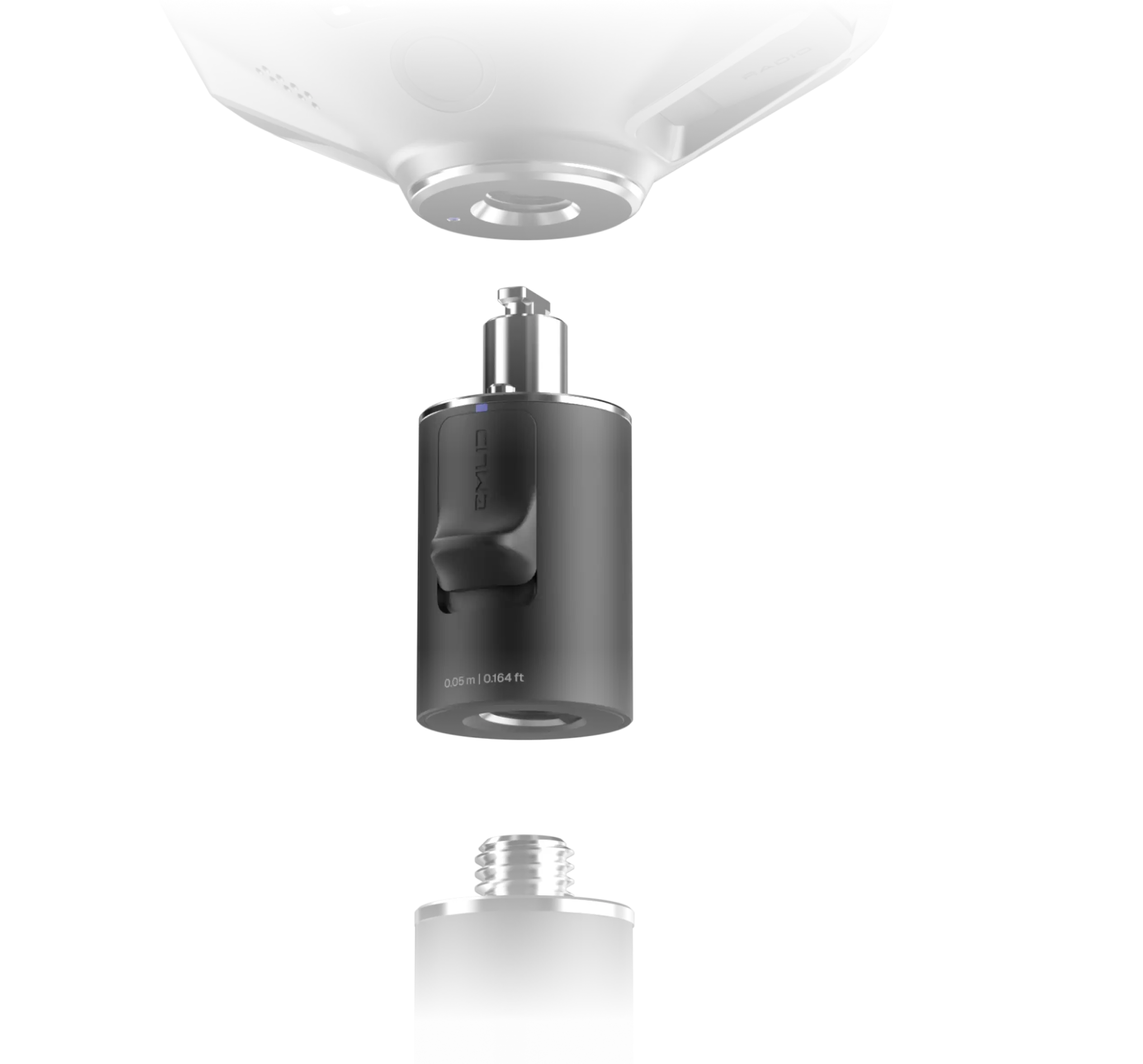

Quick release mount
The custom-designed quick release mount ensures the receiver is locked firmly to your survey pole, eliminating backlash. Even the smallest wobble can affect tilt-based measurements at steeper angles. This mount solves the issue with a fast and rock-solid connection for reliable data accuracy.

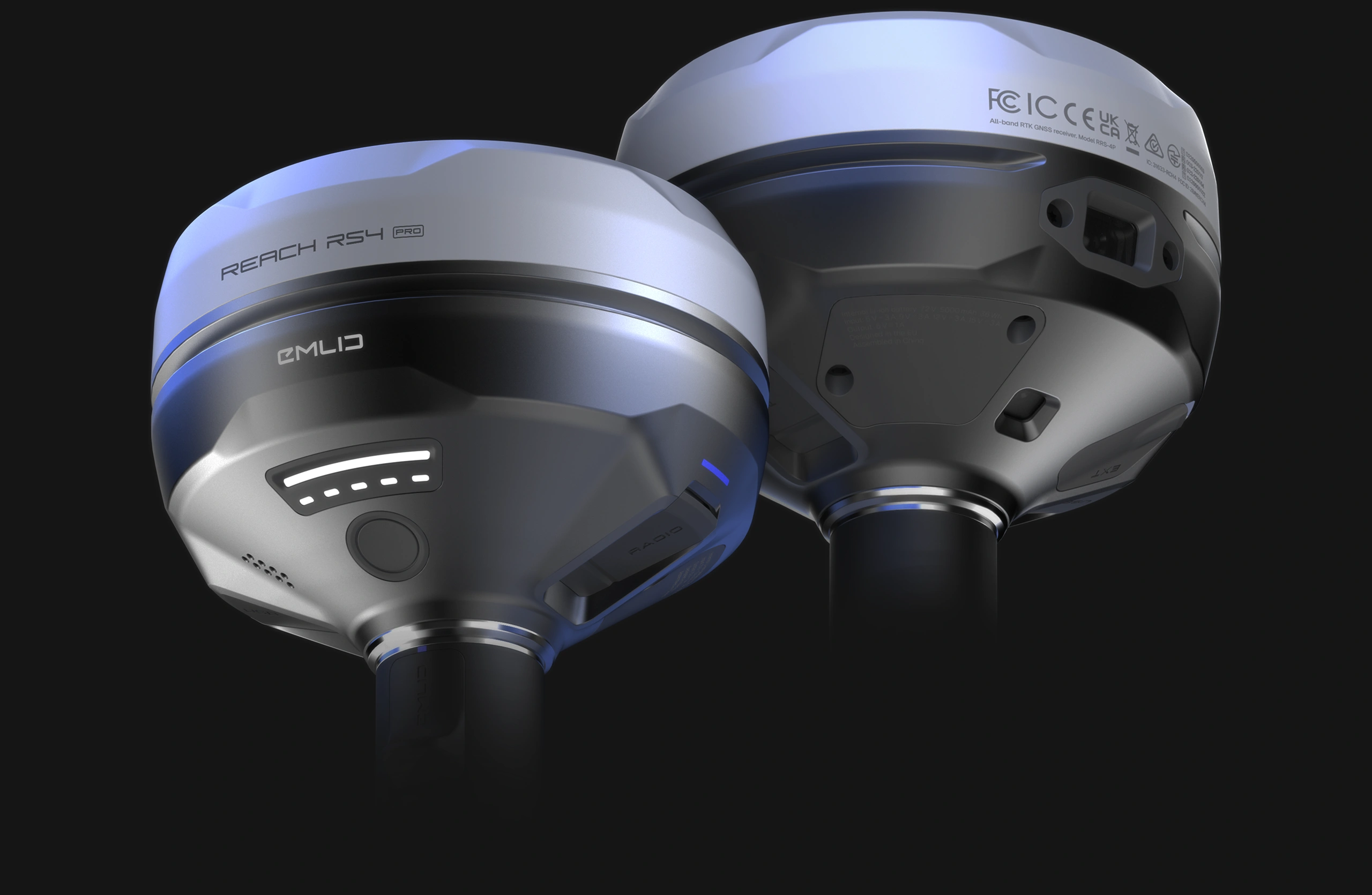

Magnesium alloy body
Crafted from the same material used in aerospace and high-end tech, the Reach RS4 Pro magnesium body offers exceptional strength without the extra weight. It’s rugged enough for demanding job sites—and light enough for all-day use.
16 hours on one charge
No need to stop mid-job to recharge. The Reach RS4 Pro runs up to 16 hours on a single charge. Power up via USB-C or plug in a power bank on the go—maximum uptime, minimum hassle.

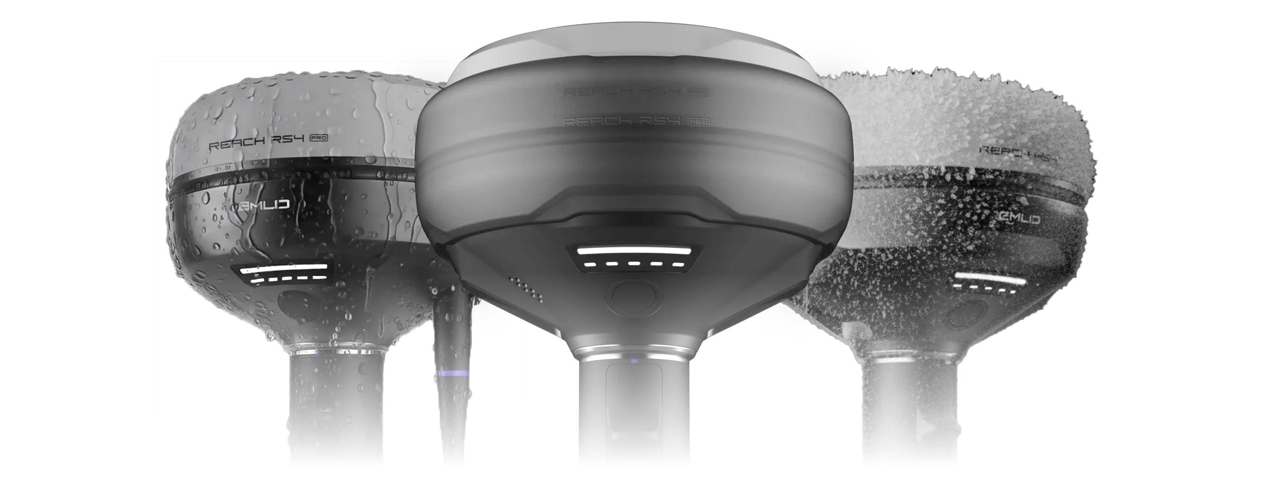

Waterproof
From rainstorms to dusty construction sites, the Reach RS4 Pro is fully ready. With an IP68 rating, it’s completely sealed against water and debris.
-40 to +65 ºС
From cold to heat, the Reach RS4 Pro performs without compromise. Engineered to operate flawlessly between -40°C and +65°C, it’s ready for work anywhere.
