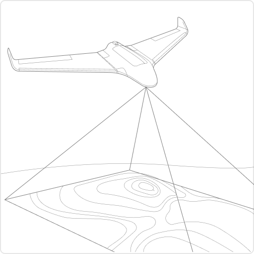

PPK mapping with centimeter accuracy. Use fewer GCPs
Why camera synchronization is so important?
Usually autopilot triggers the camera and records the coordinate it has at that moment. When the drone is flying at 20 m/s and GPS works at 5 Hz, that means your autopilot will have position readings only each 4 m, which is not suitable for precise georeferencing. In addition, there is always a delay between the trigger and the actual moment the photo is taken.
Reach eliminates the delay
Reach solves the problem of positioning by connecting directly to the camera hot shoe port, which is synced with the shutter. The time and coordinates of each photo are logged with a resolution of less than a microsecond. This method allows GCPs to be used only to check your accuracy.

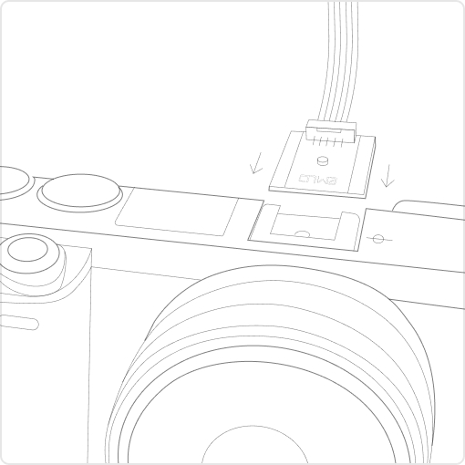

Connect Reach to a hot shoe port on a camera
1. Connect Reach to a hot shoe port on a camera
Every time a photo is taken camera produces a pulse on a flash hot-shoe connector which is synced to a shutter opening.

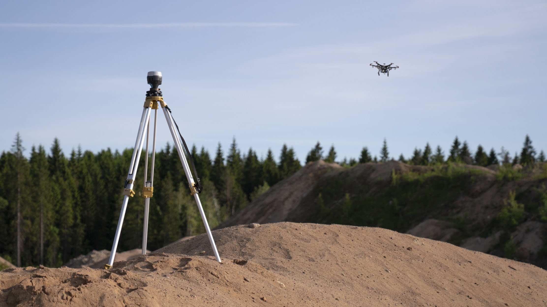

Fly a drone, Reach will record photo events
2. Fly a drone, Reach will record photo events
Reach captures flash sync pulses with sub-microsecond resolution and stores them in a raw data RINEX log in the internal memory.

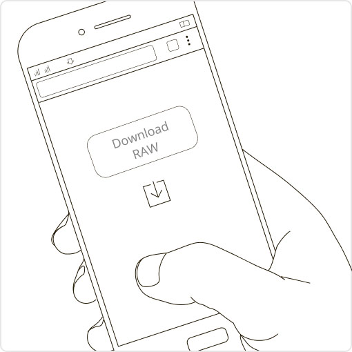

Download logs from Reach and base station
3. Download logs from Reach and base station
After the flight, get the RINEX logs from your airborne Reach module and a base station (Reach RS, CORS or another receiver).

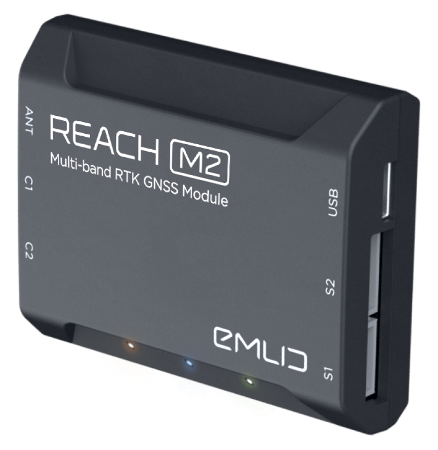

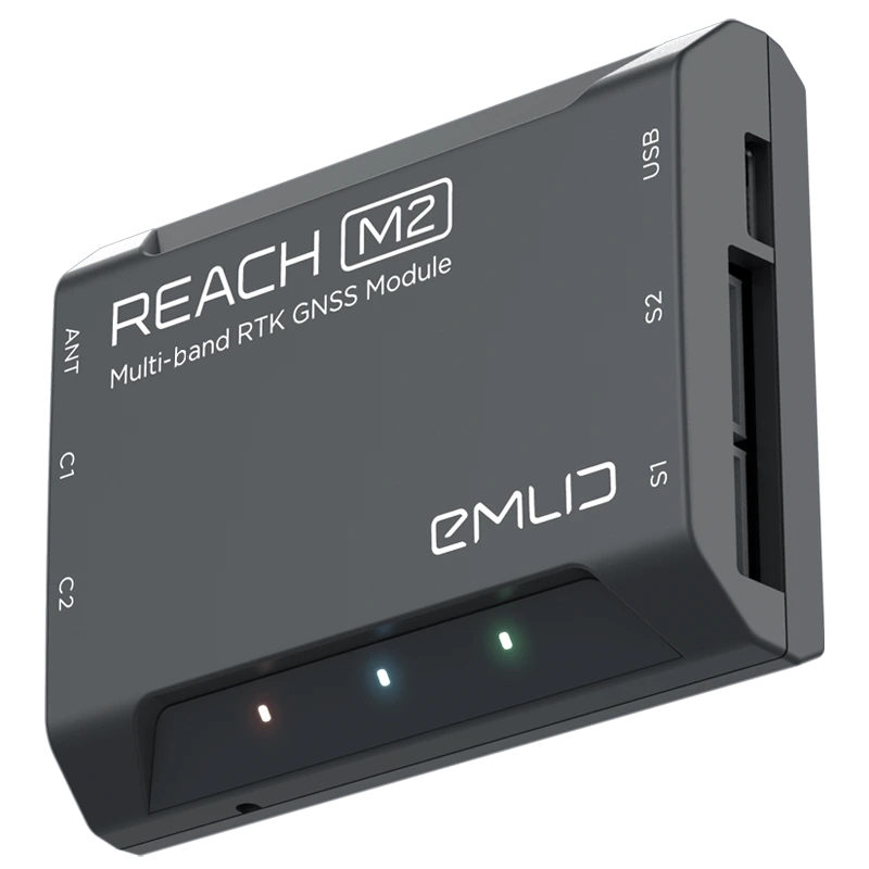

Mechanical
  • Dimensions 56.4 x 45.3 x 14.6 mm
  • Weight 35 g
  • Operating tº -20 to +65 ºC
Electrical
  • Power supply voltage on
    USB or JST-GH connectors 4.75 - 5.5 V
  • Antenna DC bias 3.3 V
  • Typical current consumption @5V 300 mA
Positioning
  • Static horizontal 4 mm + 0.5 ppm
  • Static vertical 8 mm + 1 ppm
  • Kinematic horizontal 7 mm + 1 ppm
  • Kinematic vertical 14 mm + 1 ppm
Connectivity
  • LoRa radio (sold separately)
  • Frequency range 868/915 MHz
  • Distance Up to 8 km
  • Wi-Fi 802.11 b/g/n
  • Bluetooth 4.0/2.1 EDR
  • Ports USB, UART, Event
Data
  • Corrections NTRIP, VRS, RTCM3
  • Position output NMEA, LLH/XYZ
  • Data logging RINEX with events
    with update rate up to 10 Hz
  • Internal storage 16 GB
GNSS
  • Signal tracked GPS/QZSS L1C/A, L2C
    GLONASS L1OF, L2OF
    BeiDou B1I, B2I
    Galileo E1B/C, E5b
  • Number of channels 184
  • Update rates 10 Hz GNSS
